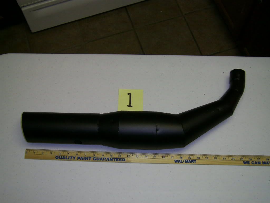

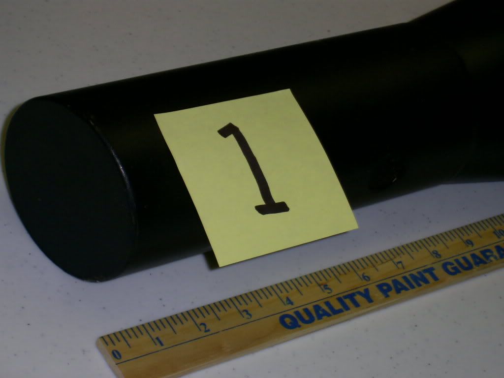

OK guys, let me try this with pics... This is two pipes. I have probably 10 that I don't know about. I'll send a few more pics later. I assume they were all used with Macs since I got these with some Mac stuff. I appreciate any help.

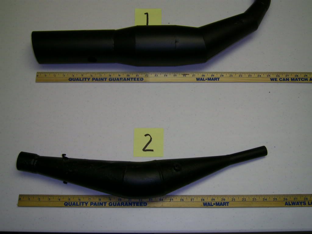

Pipe 1: About 26" long, no markings at all, widest section 4.25", next section is 3.375" (1" exhaust outlet hole in the 3.375 section) 1.875" at the intake, 90 deg offset.
Pipe 1-1
Pipe 1-2
Pipe 1-3

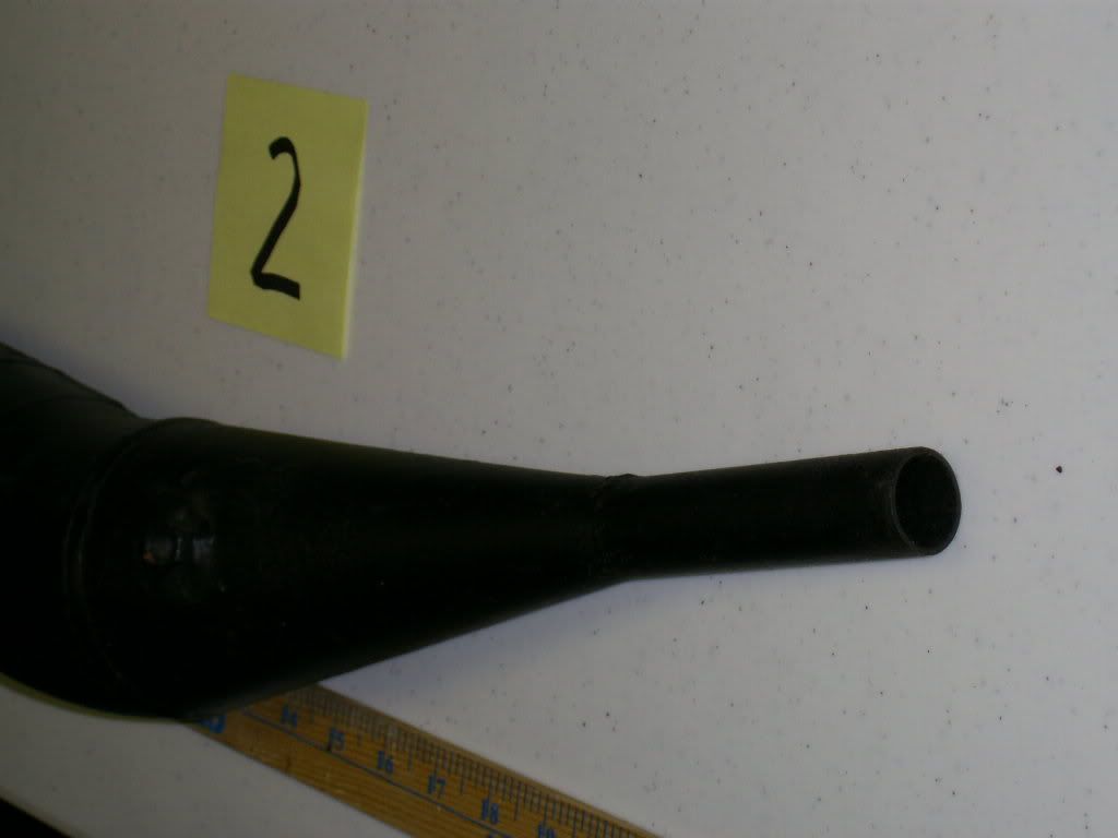

Pipe 2: About 24" long, no markings, 3.375" at widest point, about 20 deg offset I'd say, 1.875" at the intake and .875" exhaust outlet on the other end.
Pipe 2-1
Pipe 2-2
Pipe 2-3
I hope the pictures work out ok. Thx.....Ron

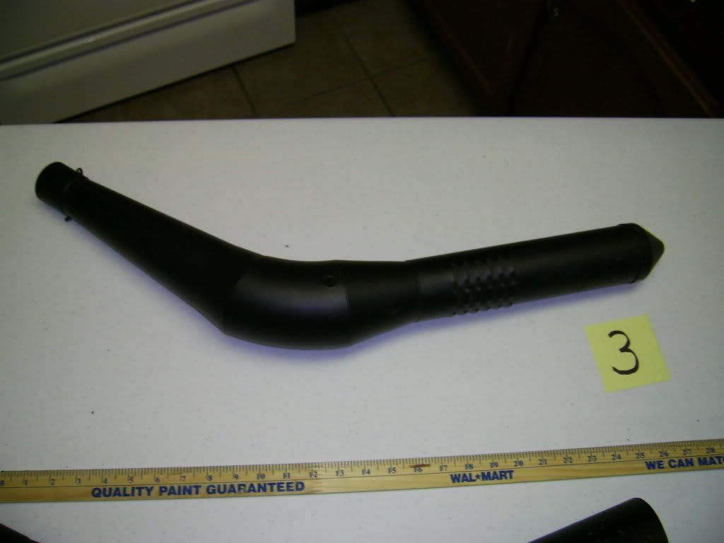

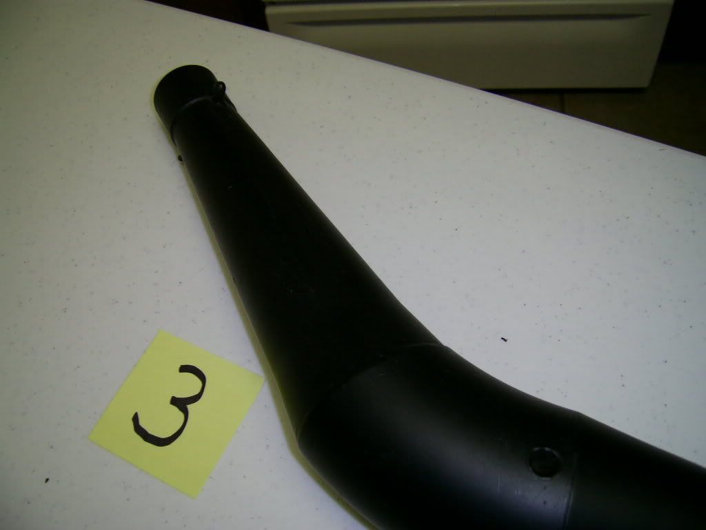

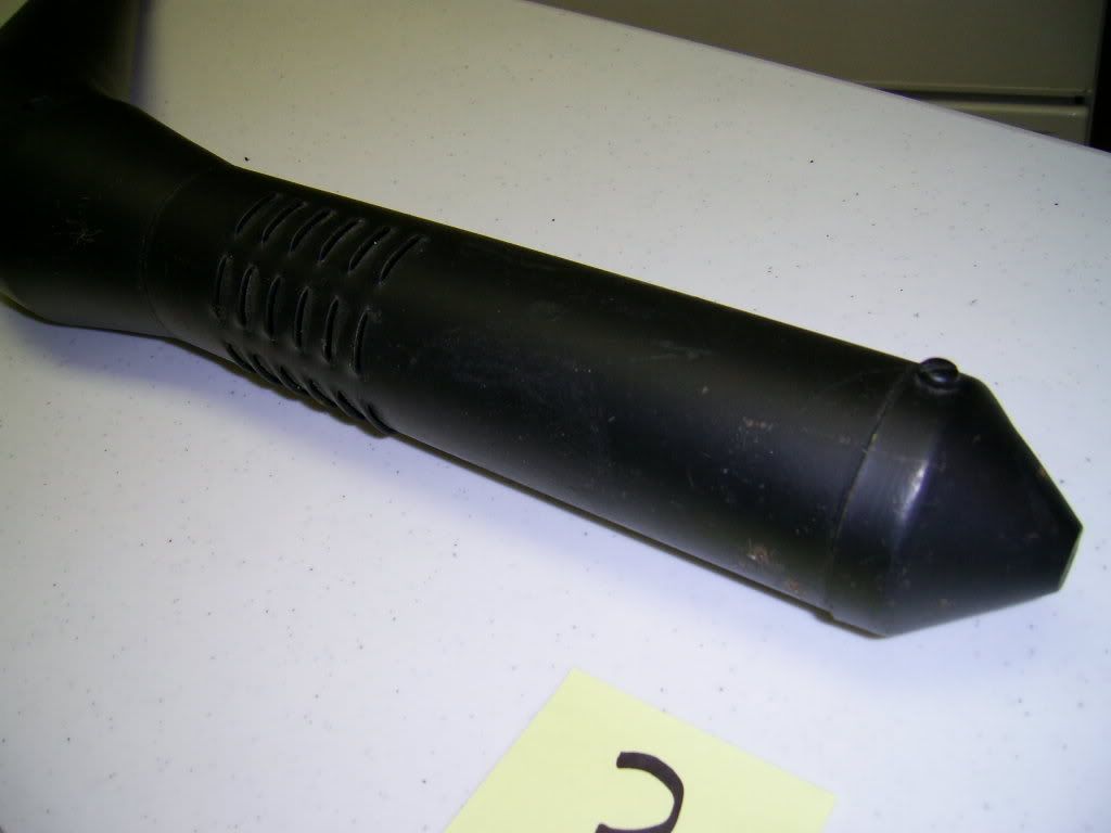

PIPE 3: 27.5" long, 3.3" at widest point, 45 deg offset, 2.5 diarest of the way to the end. 6 rows of louvers around 1/2 of the diameter (exhaust outlet), Mount hole goes all the way through. End cap has screws 1-7/8" inlet

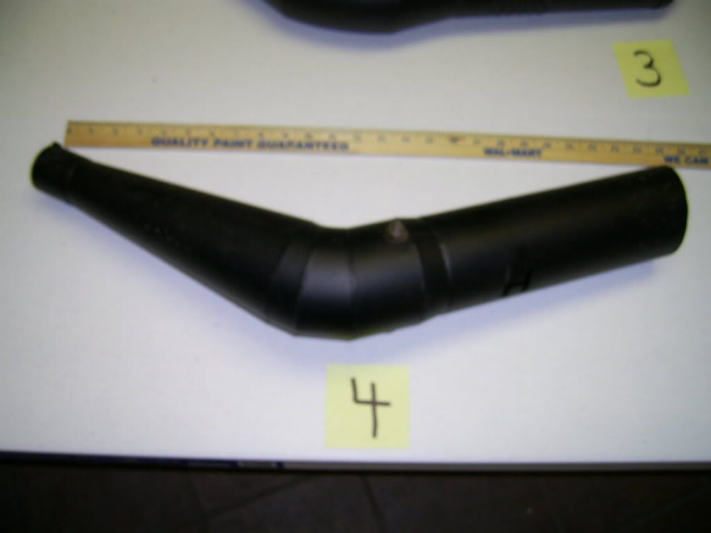

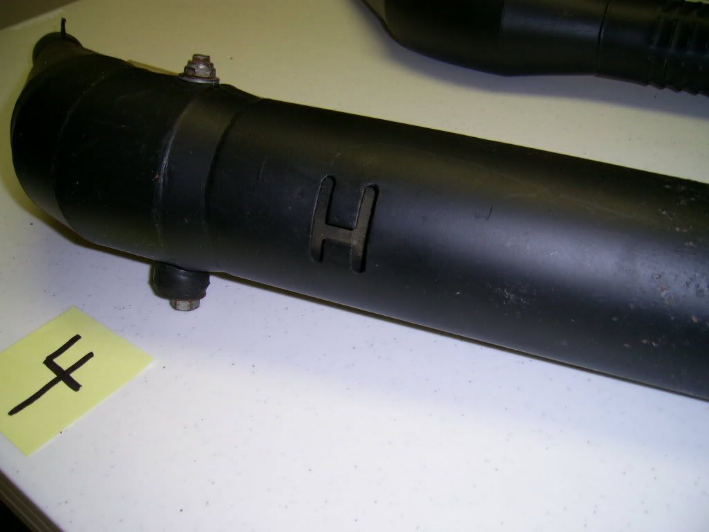

PIPE 4: 24" long, 3.5" diameter, Mount bolt passes all the way through, no markings except for big 1.5" "H" exhaust outlet on the side, 1.7/8" intake, 45 deg offset.
Pipe 4-1
Pipe 4-2

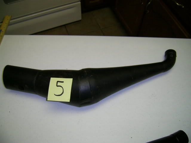

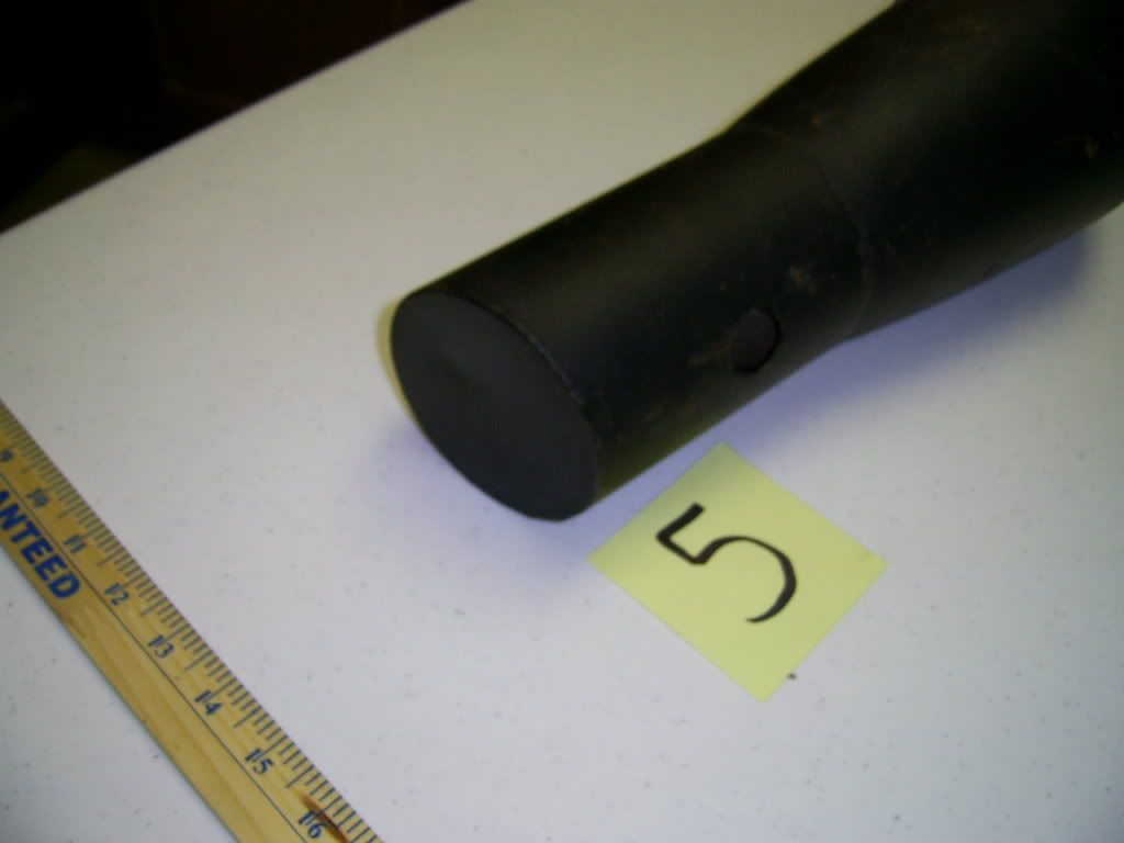

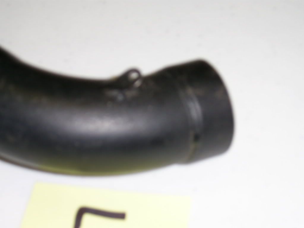

PIPE 5: 27" long, estimated 15 - 20 deg offset, widest diameter 5", No markings, 1" exhaust gas exit hole, 1-7/8" intake
Pipe 5-1
Pipe 5-2
Pipe 5-3

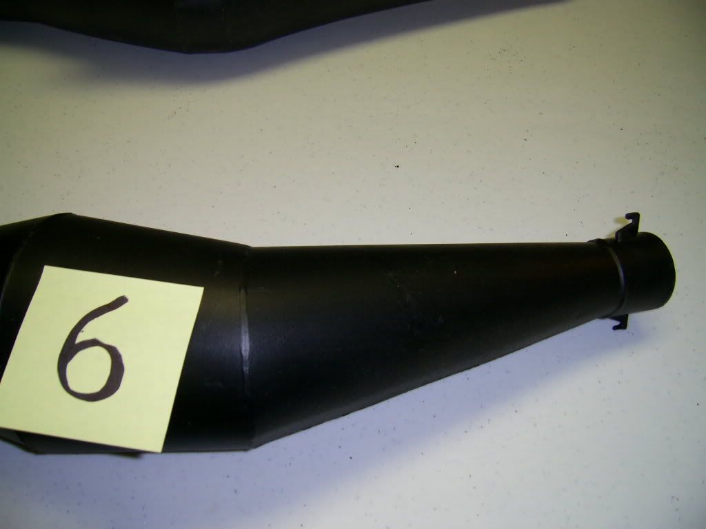

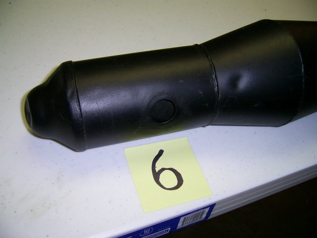

PIPE 6: 24" long, 90 deg offset, 4-3/4" widest point 1-7/8' intake
Pipe 6-1
Pipe 6-2

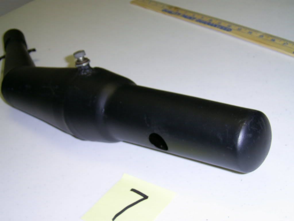

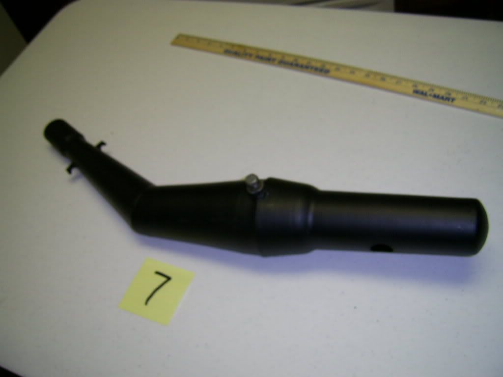

PIPE 7: 26.5" long, 3.5" widest point, Steps down to 2.25" to the end with a 1" exhaust discharge hole in this section. Rounded end, 1-1/2" intake
Pipe 7-1
Pipe 7-2
That enough for now....Thx...Ron
Pipe 5-1
Pipe 5-2
Pipe 5-3
Pipe 6-1
Pipe 6-2

Re: ID for Expansion Chambers/Tuned Pipes
Pipe 3 looks like a Kendick
Pipe 5 looks like a Kathy Hartman KH9. it shoudl be very light on the end cap of the pipe.
Pipe 6 is a Gary Hartman blimp pipe.
