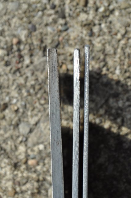

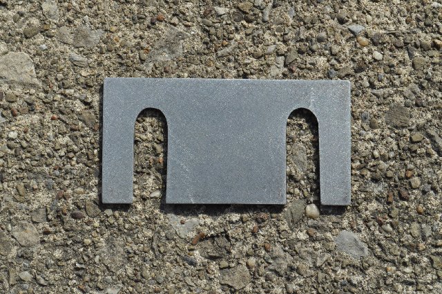

To combat the need to move the sprocket hub I have made up a series of 'spacer' plates in 3 different thickness's that I can drop in behind the motor sideplate and my Unimount or any flat GEM style baseplate for that matter which will give me a way to align my clutch sprocket with the axle sprocket without the hassle of moving the sprocket carrier on the axle. This set-up is fast, its simple, and its inexpensive.

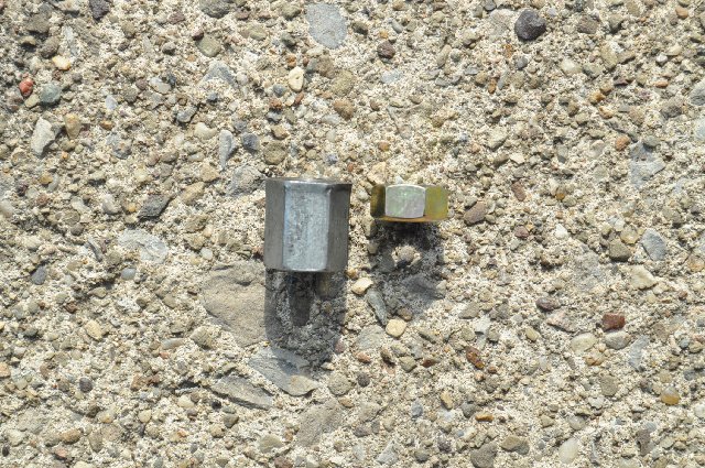

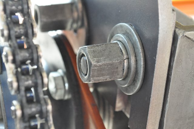

While we are messing with chains and motor mounts there is one other thing I found to aid in chain adjustment and that is using coupling nuts in place of a standard bolts to secure your side plate to the mount. Coupling nuts are essentially a longer nut and that little extra protrusion on the hex really helps to get a wrench on the bolt to tighten down the sideplate.

I bought an extra long ratcheting box wrench, and a 9/16" URREA 1218L extra long combination wrench so I can reach from under the kart to get at the side plate nuts. Either wrench works well to solve an annoying problem where there isn't room between chain and mount plate for a ratchet and socket. Ted
