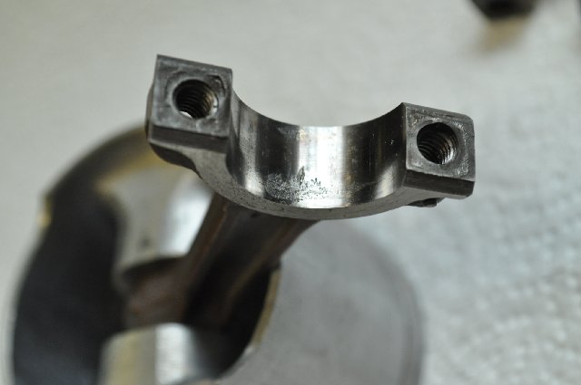

Started a rebuild on a Mc 91 and the first thing I was met with was a bad rod. The rod problem is nothing new and it just backs up the thought that these old engines need to be taken apart and given a close inspection before they are run. You don't know what you got till you take a look inside.

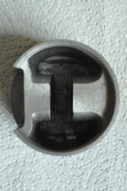

Now here is where it got interesting. The piston, bore and rings were in great shape and could be saved so I needed to get the piston off the rod but the style of the piston was the solid bearing pocket out at the exhaust side and I had no access to pull the pin so I had two options, push the pin and the bearing out of the piston on the exhaust side, then re-install the bearing or try and tap the wrist pin and pull it out on the open end.
I didn't want to mess with the pushing the bearing out and then having to re-install it so I decided to pull the wrist pin out on the open end bearing and to do this I was going to tap the wrist pin to allow me to thread in a jack screw set-up.

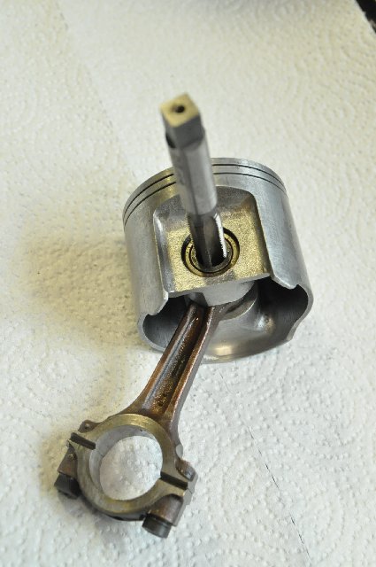

First thing I did I measured the I.D. of the wrist pin and it was a good candidate for a 3/8" thread diameter. I knew the pin was going to be pretty tough just because of the nature of its use so if I was going to tap it I would need a good name brand hi-speed or cobalt tap and luckily I worked at a tooling distributor in the past and they were able to provide me with a 'Cleveland' brand 3/8"X24 4 flute tap. I went with High Speed Steel because they were out of cobalt, same with the 4 flute instead of 2 but I figured what the hell.
Next thing I did was pack some tin foil down in the wrist pin because I didn't want any metal chips getting into the closed wrist pin bearing as I was tapping, then I tracked down my trusty bottle of Castor Oil tapping fluid from a tech article from days gone by and I was ready to go.
Tap lubed, wrist pin lubed, give the tap a twist. When tapping you can tell right away if your cutting or rubbing and I was met with a nice cut. As I was cutting into the pin I kept very close attention to the flex of the tap and made sure I took small cuts that were very well lubricated.
The tapping procedure went very well and gave me over a 1/2" of nice thread to screw my jack down into.

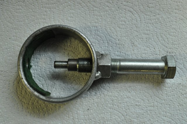

O.K. first hurdle cleared now its on to building a 'jack' mechanism and I knew the easiest way to build the jack would be to utilize my existing wrist pin push-puller.

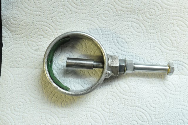

My wrist pin puller has a 1/2" inner diameter thread but my wrist pin was tapped to 3/8" so I wanted to sleeve down the inner diameter so I had a better fit on my jack screw so I found a old 3/8" pipe flare nut that had 1/2" OD thread and my needed 3/8" I.D. Next I found a 3/8X24 bolt and nut which would be the jack nut and I threw a washer in between just for good measure.
I heated the whole assembly in my second hand store toaster oven before I tried to pull the pin. Heavy gloves on, I pulled the piston assembly from the oven, threaded the jack screw into the assembly till it stopped turning then I started to turn the jack nut and it pulled the pin right out of the rod. Success !
