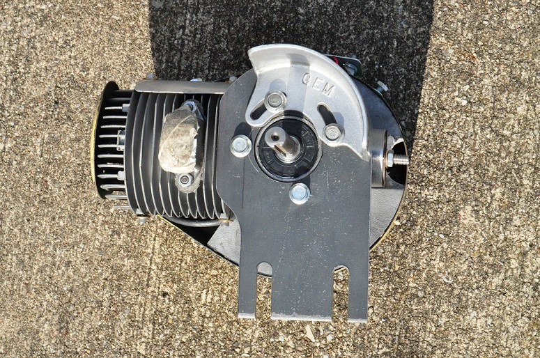

If you read the Colossal Clinton thread on Terry Sullivan's big inch Clinton motor you know that I made mention of a Clinton E65 I acquired form Terry Sullivan and John McCorvey a.k.a. 'The Putt-Nik Dude. Well now its time to get the motor bolted up and fired up.
Since all of my karts have Rupp Uni-Mounts and I'm pretty sure no one ever cast a mounting plate for a Clinton to Dart Uni-Mount set-up I had to make up a steel side plate like those used to mount Mc and W-B engines. Since the Clinton engine is wider then the other engines a offset side plate with a chain guard was in order so the engine would clear the seat back tank. Basically I needed to move the engine rearward on the sideplate for the clearance I needed. Simple enough job, get a piece of 3/16 steel, Scribe out the plate with the needed crank centerline offset, cutout the plate, drill some holes, cut some slots. The G.E.M. chain guard I used had slots in it already so it was a simple bolt up.
Next up, a custom built lightweight clutch that anyone can build at home so stay tuned.

Nice work there-it seems that I am in a similar situation with mounting a West Bend 580 on my Simplex....Sometime in the kart's past life, someone modified the rear engine mounting plates and now it looks like the clutch will not line up with the sprocket.....I guess I'll have to make a new mount.

Make an intermediate mounting plate from aluminum plate rather than change the original mount...........unles it's already thrashed.
