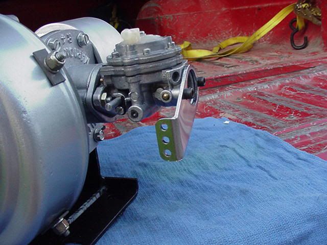

Ted I just posted this without problems....... but it can't be oversize.
