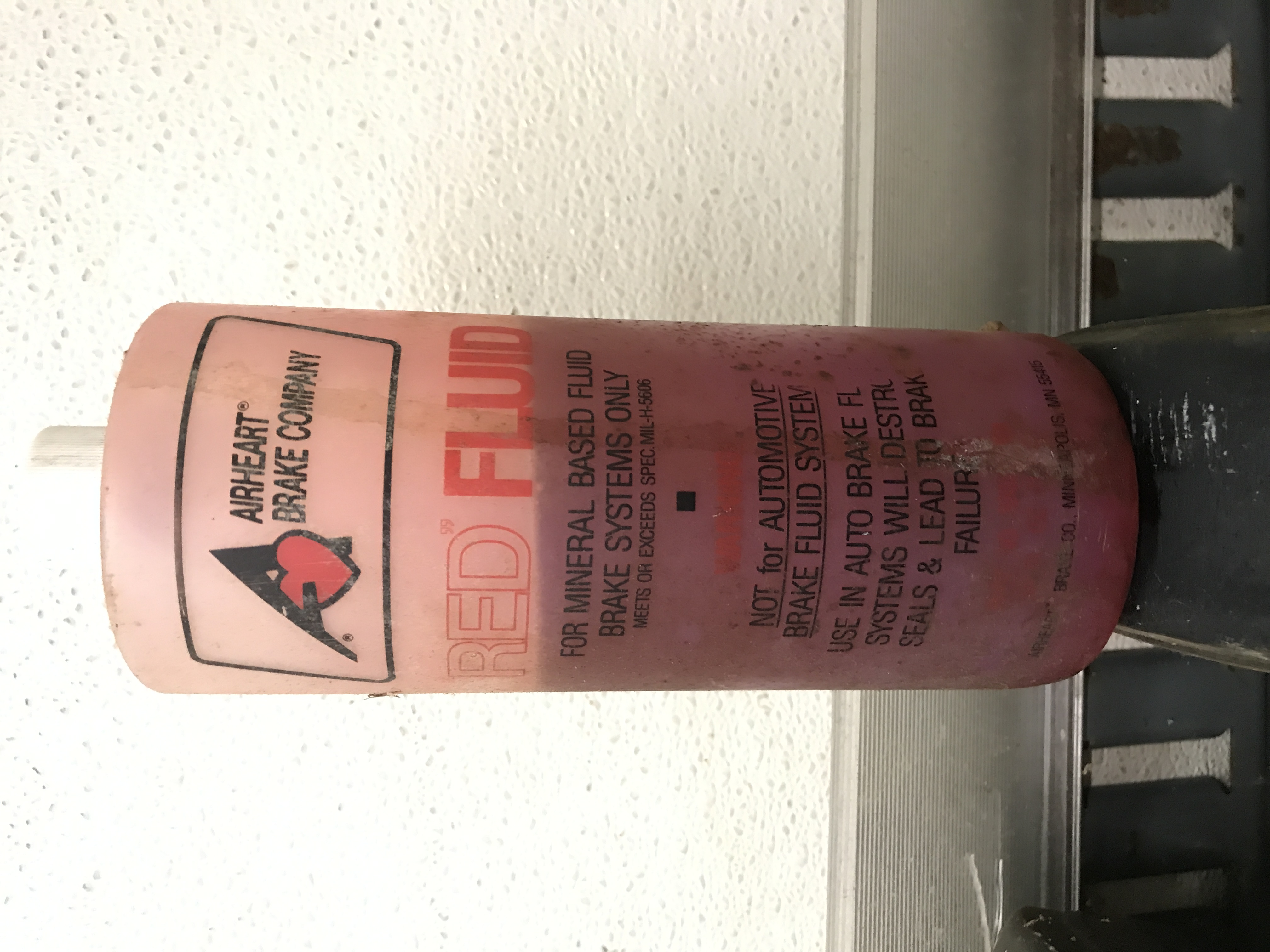

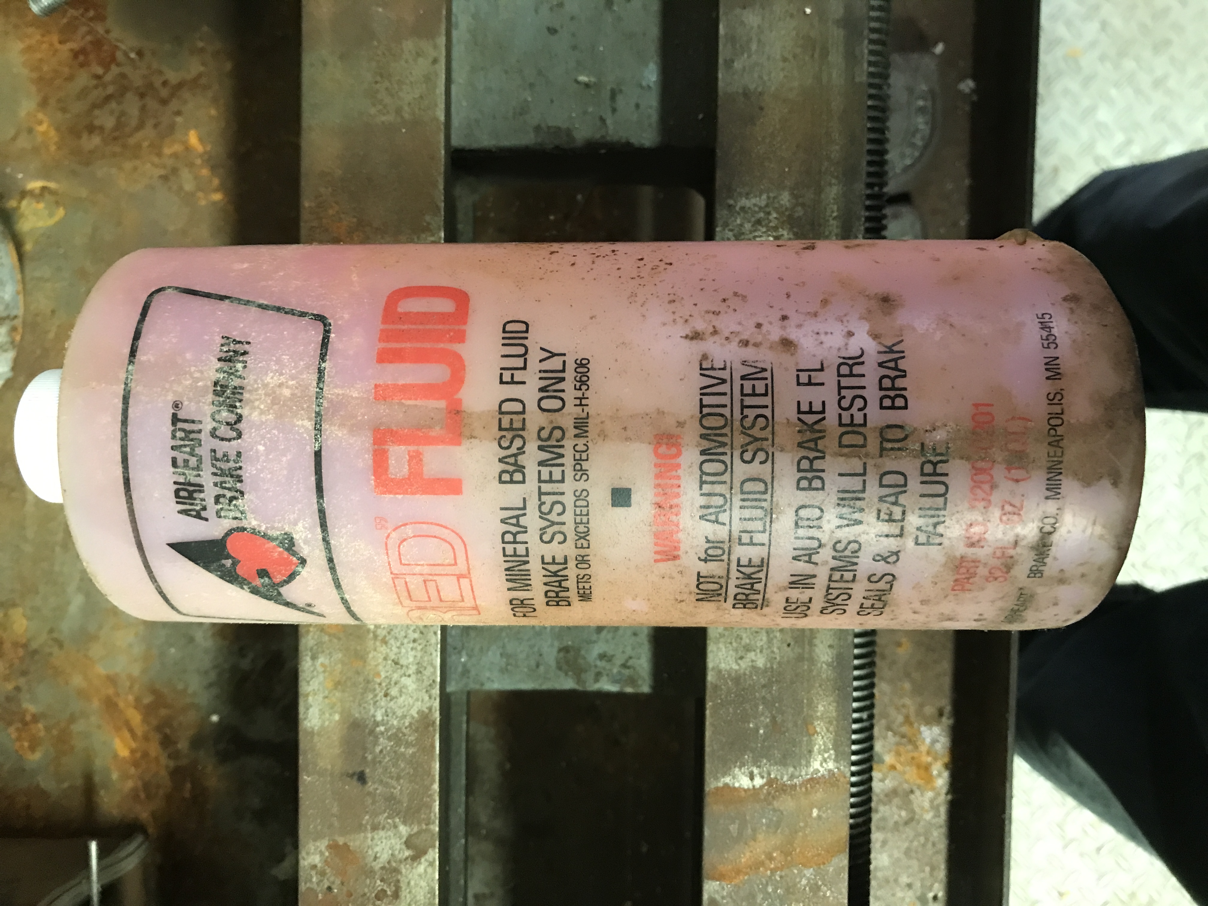

Post by Rich Lanyi » Thu Jun 05, 2025 3:54 pm
I was looking in my shop for something else today and found this. Not sure if it has a shelf-life.
Posts: 1722
Re: QUESTION: Airhart Hydraulic Fluid?
Post by Rob Voska » Fri Jun 06, 2025 5:53 am
No, mineral based brake fluid is not hygroscopic, meaning it doesn't absorb moisture from the air. DOT brake fluids, on the other hand, are hygroscopic. This means that DOT brake fluid will absorb water from the air over time, which can reduce its boiling point and lead to brake system issues.
